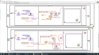

I'm making a VI to generate a pulsed analog signal and deliver it to the hardware device with an NI board.
My goal is to switch the operation of the for-loop freely without quitting the VI.
In the front panel, I want to start the for-loop when I press "start" button and end the iteration when I press "stop". (Both buttons are on the right top side in the figure)
The problem is that after I press "stop" once, the whole VI goes frozen and does not work.
I want to have unlimited use of "start" and "stop" button without quitting VI.
The attached VI is the one I made so far and is there anyone who can help me?

First of all, avoid using Local Variables.  Use wires and the actual terminals whenever possible.  Doing this will also eliminate the need for the Sequence Structure, letting the data flow determine the order of the code.  This will help you immensely in organizing your code.
Now, if you want to update your values inside of a loop, you actually need to be in a loop.  The only part you actually need in the loop is the waveform generation and the DAQmx Write.  I would stop the loop if there is an error or the stop button is pressed.
Attached is a cleaned up version of your code.  Hopefully this helps.

According to your advice, I removed the outer while loop and made two other while loops corresponding to two inner while loops each.
However, same problem occurs and I still don't understand why the circled two DAQmx write and start blocks make errors and are not independent each other, checking with highlight execution debugging.

Hi jie,
Which errors do you get?
Which hardware do you use?
Does your hardware allow you to start two tasks in parallel for this hardware?

Actually, I connected two cameras and two lasers in ao0 with BNC cables like octopus legs and also connected a galvanometer scanner in ao1.
I solved the problem with removing one inner loop and change DAQmx write block's option into multi channel like the picture below.
Your advice helped me a lot. Thank you so much.
