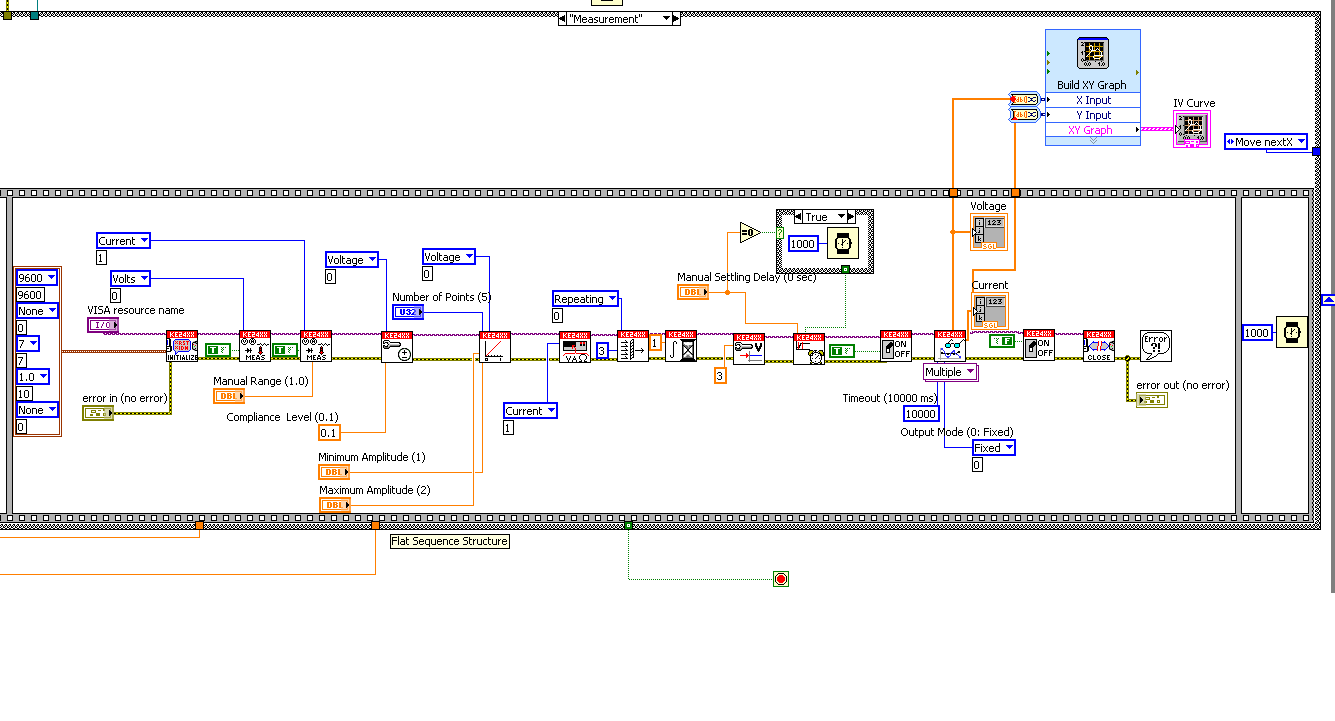

I´ve made a small program (re-using one I found in the web) in order to generate an IV curve using Keithley 2400. I want to sweep voltage from -1 to 1V using for example 10 points and obtain the current both in a graph and in a table.
However, something is wrong because I only get one measurement (not even correct) and no image in the graph and no data in the table.
Could someone advise me here, please?
Any help is welcome!

Recommendation 1: Show us your code.
It is very difficult to troubleshoot a picture -- and doubly so when the picture doesn't show all the code.
Mike...

Hi mikeporter,
I´ll attatch the code in a while. However, the rest of the code is just for moving some motors meanwhile the picture shows the measurement process. The problem is that I have to move motors, measure, move, measure,... and let the code running for days without interaction, so the examples I found on internet don´t solve my problem.

Hi mikeporter,
attached is the code! Feel free to take a look (don´t be scared, I know is a dirty-made codeSmiley Embarassed). My problem is on the measurement stage using Keithley drivers (I guess).

You should keep you questions related to a particular VI to a single thread, but I will give you a couple things to look at:
  1. Is the loop is stopping after just a single iteration?
  2. Is the state machine continuing to run but is not getting back to the Measurement state?
Mike...

First, thanks for the advice (I though that I had to create another post, sorry for this misunderstanding).
About your "questions",
The program runs for the different stages using the loop correctly, the problem is how to adquire the measurement data (it starts moving to one given position, then measurement should be done, move to next position and repeat).
