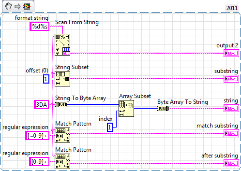

There are many more ways, here are some I can think of:

yes i would want to strip the 1st nibble,

Thanks Ace for the examples found them very useful.
