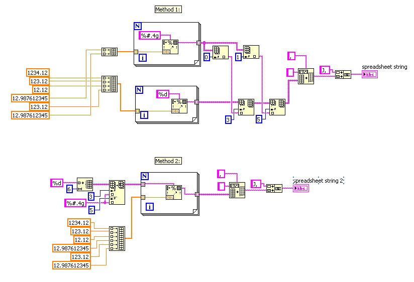

can anyone tell me, now, if there's a way to take multiple dbl's and combine them together to look like this with formatting?:
J,1234,123,12,12.9876,123,12.9876

Jim,
Since the doubles have different formats (some as integers, some with 4 decimal precision), it is neccessary to format the strings individually before using the "Array to Spreadsheet String" function.  I couldn't find a "pretty" way to do this, but I've attached an example showing two different ways which accomplish the same thing:
I hope that helps!

You could also just do this:

Very true!  I knew there was something simple I was missing.  Thanks smercurio_fc!
