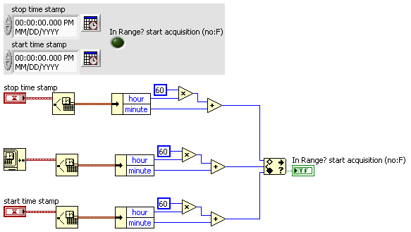

you can also try this.....forgot to include in the text:  OFF-0000 to 0400?     Smiley Sad
Message 5 of 13
(5,087 Views)
Message 6 of 13
(5,081 Views)
The case structure would not be a very good way to do this since the code would have to be modified in order to change the start and stop times. In addition, none of you solutions allow you to start/stop the system on anything other than on the hour. The comparision above and teh In Range comparision both are workable but should be expanded at least allow the start/stop time to include the minutes.
Implemented in the state machine it makes more sense to have states to explicitly check for the start and stop times rather than a single comparison for all of it. The code is a bit more clear with explicit states.

ok, ok....im just a padawan! btw, take care of your coercion dots....Smiley Wink

Actually coercion dots aren't always a bad thing. Removing them can actually decrease performance and not actually benefit you. There is generally no harm when the switch is basically between a signed and an unsigned value. Or when coercing a smaller number (U8) to a larger number (I32). As long as you fully understand why the dot is there and know the data types you are switching between you can safely ignore them.
