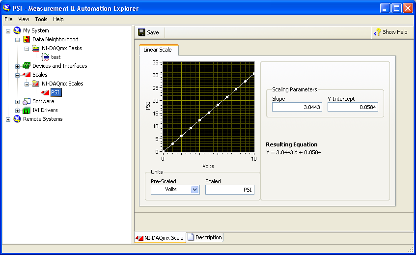

the DAQmx you use gave me a similar setup page to DAQasst, so I thought I could use them.  The filters, I figured they would do a rolling average ten iterations of DAQ.  I did have good front panel output of filters... played with the numbers. The formula nodes are necessary, well, almost.  I'll use math functions and constants to replace formula node.  Probably faster.  I am not rescaling, I am translating voltage to pressure.  Need to read psi.

A task is a collection of channels, timing, triggering, scales and other properties.  In your case for this application you could create 1 task with 10 channels since all of your channels are AI nSample on demand.  You can mix chanels from multiple devices!
Dev1AI0 can have a scale (ch1_scale) that is linear Slope=3.0443 Intercept=0.0584 and scaled units = "PSI"
cDAQ1Mod1AI0 has a "built-in" scale for a pt thermistor- you applied that scale by selecting the RTD type.
The DAQ config assistant can be launced from a number of places.  I often use MAX to configure my tasks and test them as I build them.  After saving a task in MAX (with any scale I create) You can Drag the task from MAX to the Block Diagram of the VI you want to use it on!  Since the task is already saved and configured you don't need to re-create it in LabVIEW so you merely need to start it and stop it!  If you need to you can even let LabVIEW creat an example of how to use the task for you!
