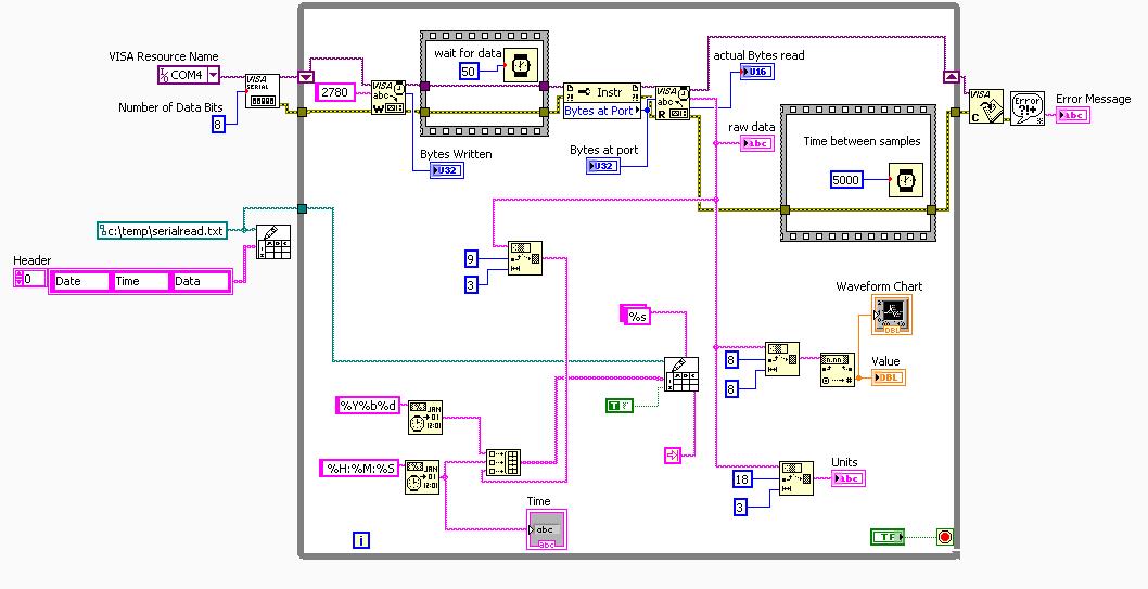

Installed new comm board.  It now works using hyperterminal.  Still gives this output with LabVIEW.  I'm writing an esc-P (2780) to request data - that's the Bytes Written = 2 component.  For some reason I'm reading around 400 bytes (it changes at each read).  I'm still not convinced, that it's not a scale problem.  If the LabVIEW code looks good, then how would this be troubleshot?  Here are the current front panel and block diagram (the scale contains an object weighing 6.310g)...

You are sending the wrong data in the VISA write command.
Escape is Decimal value 27.  But it is 1B in hex.  And P is decimal value 80.  But it is 50 in hex.
If your string constant is in hex display, then it should show 1B50.  Not 2780.  2780 means you are sending it apostrophe and whatever decimal 128 is in the ASCII table.  (I don't have an extended ascii table in front of me right now.)

Duh!...thanks (about the ASCII).  However, it is still sending 400 bytes of data at each 5 second interval (after I made the change to the write buffer).

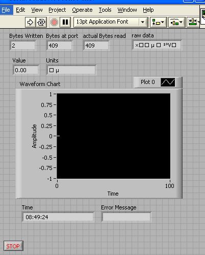

Are you sure you are supposed to be getting back some ASCII formatted data like the manual says?  Is there any parameter setting in the device that controls this?  It sure looks like you are getting back binary data.
If you expand your Raw data indicator to see more characters at once, does it seem like there is any pattern to what you are receiving among those 400+ bytes?
Post a screenshot of how it looks when you do this in Hyperterminal, then post a screenshot of your LV front panel, but with the Raw data string enlarged to show the 400+ bytes.

Here's the front panel...

Check the parity and data bits of your serial port again in Hyperterminal vs. LabVIEW.  I can't think if any other logical reason why Hyperterminal should look so much different than the data you have in the raw string indicator in LabVIEW.
I see what looks like data repeating every 15 bytes in LabVIEW.  Put an indicator on your error wire to see if there are any errors coming out of the VISA read.
If you run your VI again, stop it.  Save the front panel controls as default, then post your VI.  Maybe looking at the hex values of the bytes you are getting will shed some logic on why the bytes look like they do.
Other things to troubleshoot.  Try running portmon and capture a log of what is being sent when you use hyperterminal.  Compare that to what is being sent using LabVIEW.
