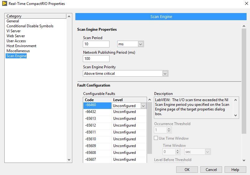

scan engine setting
I'm working on cRIO 9035 with scan mode, the scan engine setting is 10ms for scan period, 100ms for network publishing period. In the code, the timing source is synchronized to scan engine, dt is set to 100. Does this mean the scan engine run at a rate of 10ms per scan and completing a total of 100 scans per execution, and output one value for each data channel? i.e. 1 Hz data sample rate. Thank you guys.
