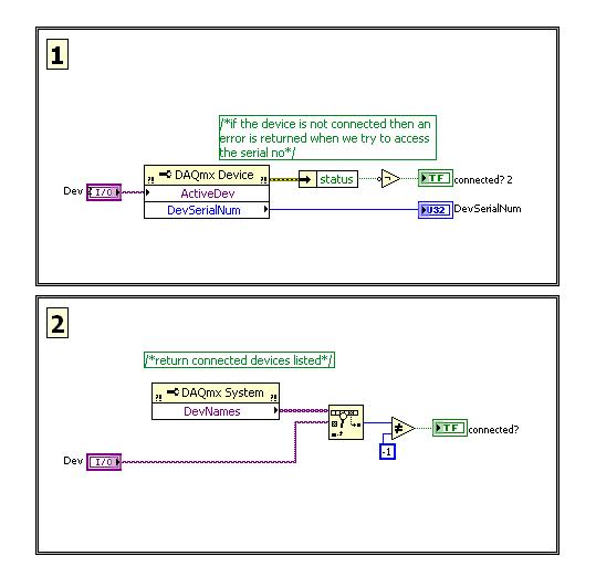

Hi, I am using a USB6211 with windows XP, LabVIEW 2009. The card in integrated in to a measurement device that the user will plug in when they want to take measurements, and then remove once the measurements have been made. The user will do this a number of times accross the duration of the test.
I have written some code that determines when the device is plugged in or disconnected and this seems to work well, however I have randomly had a full windows crash and I am wondering if this is due to the plugging/unplugging of the device from the USB.
I have had a search and the post below implies thats this is safe to do, however I want to make sure that this isnt going to cause me a problem down the line.
Any ideas?

Hi, thanks for the replies - the devcon utility might be useful for me in the future however I managed to solve my problem as follows.
In my original code (figure 1) i was trying to access the serial number of the device, which if connected return error = FALSE. If an error was detected i would retry after 5 seconds, however if the device was connected/disconnected whilst comunication was in progress windows would crash.
I have now modified the code to check the active device names (figure 2). If my device is not connected then the search function will return index = -1. Because I am no longer checking the device directly it no longer matters if the device becomes connected/disconnected during the check.
