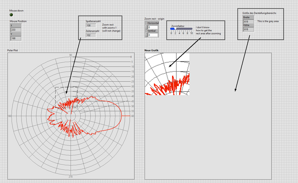

Hello sir,
Thank you very much for the quick response. With your suggestion i have done up to some extent. Now I'm facing issue during mouse up event. The selected area is not able to adjust to the full picture.
Kindly check the enclosed VI and suggest me for further changes.

You did a good job getting a section of the picture, but you forgot to do any zooming.
You may need to add some special code so that when you scale it up, it picks a scale factor that allows your image subset to fit. It is unlikely that you'll pick a rectangle with the same aspect ratio as your picture indicator, so either one direction of the picture would get cut off, or the other direction will need to have a larger area shown than what you drew with the rectangle.

Here is how I would do it with the zoom factor based on the relative sizes of the original picture and the zoom rectangle that doesn't cut anything off.

Hello sir,
Thank you very much for the solution. I have modified the VI as per my requirements because i'm having only one picture control and we can do the multi level zoom in the displayed area. I have observed few things
1. The behavior is abnormal, If I do mouse down in the picture control and drag out of the picture then mouse up or vice-versa.
2. During Muse up event, the rectangle to be disappeared. I tried, but still rectangle is visible.
Kindly look in to the modified VI and suggest me for the changes.
S Nagaraju.
02-07-2019 08:05 AM
1. Add a Mouse Leave Event. In there you can put code that ends the entire mouse draw operation resetting your flags.
2. (And you'll want this for #1 as well) Put your terminal for the original polar plot inside the mouse up event and use a local variable outside for the one time you initialize the plot. When you have a mouse up, send the original picture to the original plot. This will give you a view without the rectangle that the mouse draw process created.
