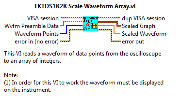

The first blue function is "Read Waveform to Array", and the second "Scale Waveform to Array"

And another a quick question. What's the difference between a scaled graph data type and a scaled waveform data type? These are my two outputs of the for loop. Since i have them  tunneled into an index, they will
be outputted as arrays. From my understanding if i connect these to a graph they should display every plot onto the graph right? However i feel that the scaled waveform is used for different purposes.
(This is an educated guess here.)
3.) The data downloaded from the scope is probably 16 bit signed integers; this is typically Tek's preferred format. The plot will accurately display what you see on the scope screen. However, you may want to know the real voltage displayed on the scope. This is done by multiplying the integers by a scale and adding an offset, (y = mx + b). I believe this is the scaled waveform.

The code is fine only if you want separate acquisitions and don't care about the relationships between the three.
The dbl array is just the raw voltages. A waveform data type is a basic type in LabVIEW. It contains t0, dt, and the y array. Your graph will display the correct x scale only of you use the waveform.
