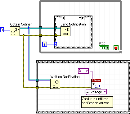

but all of the sudden i have to add a frame before the current frame.
there is not other way around it?
i thought the idea is NOT USE STACKED SEQUENCES. and it ended up that i have to?

flat sequences are usually bad, stacked sequences are always bad.
what you can do is wire your occurrence into one fram of a flat sequence, and in the same frame, place a control or constant for everything that needs to be delayed.  the outputs will not occur until all the code has executed (namely your occurrence) so it will delay the rest of your code without putting it all in a sequence frame.
The value of the control will not register as a frame output until all the code has executed, leading to the functionality you want.

There are many ways to order the execution of nodes in LabVIEW. One way that is increasingly rare (as you noted) is to use Sequence Structures. The more common way is to use the Error Cluster inputs and outputs to order execution of things. The occurrence functions don't have error clusters, so they don't help you much there, but Notifiers do. Notifiers are like occurrences, but you can send data as well.

wow, nice..thanks for the diagram and picture.
i will try this on monday when i get back
