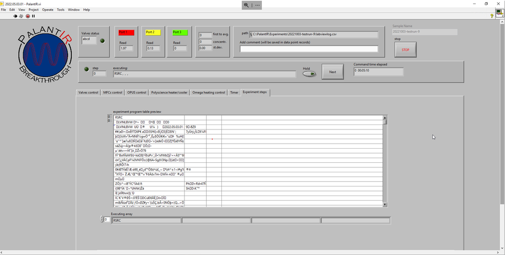

"RSRC" error - no idea what is happening here
I've been using this VI for a few years and it has always run smoothly. When I tried to run it today, it wouldn't start - where I usually have the chronological program steps displayed, there are just a bunch of random characters (shown in attached photo). Does anyone know what could be happening or how to fix it?
Do I need to update LabView? I've been using LabView 2017 all this time, so I don't think that is it.

Looks like the program loaded a VI instead of program steps.
Scroll down to the bottom of the table to see the name of the VI.

I scrolled to the bottom and all the characters are illegible. I also manually selected the .csv file that the code reads from. I'm not sure what else could be happening?
(1,420 Views)
If you intend to open an .csv file, maybe the file got messed up.  Try to open the csv file in a notepad.
Have you changed your code lately?

Hi chemme,
Well, that screenshot clearly shows the VI is running!
Apparently your VI is loading a configuration file (or recipe) - and somehow you (or someone else or your VI) is loading the wrong file now. Another possibility is you (or someone else) has overwritten your recipe file with a LabVIEW VI…
Solution: get your backup and restore all the needed files from your backup!
