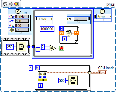

My PXI controller is an 8108, which has a dual core Pentium of some kind in it.  Accordingly, I get two CPU Load reports, one for each core.  It's pretty clear that the Timed Loop is running in Core 1 (as the time goes up as I increase the computing inside the loop).
As shown here, the Timed Loop runs for three cycles at 0.5 Hz, trying to compute a million random numbers (seems to take a fraction of a second, maybe 50-100 msec).  At half-second intervals, I get the CPU Loads in a separate loop.  To ensure that at least one of the measurements gets a full cycle of the Timed loop, I delay the Timed Loop start by 1/4 second.

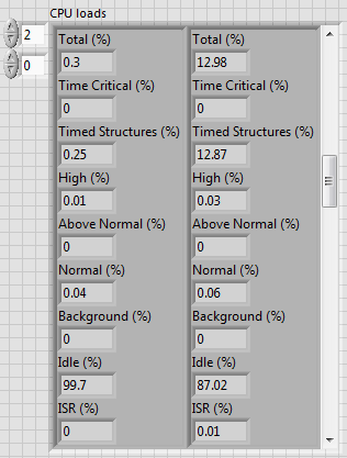

Here's what I get on the fourth measurement (the second through fourth are similar).
You will notice that Core 1, which has the Timed Loop, is busy 13% of the time, while the other loop is only 0.3% busy.  Looking over all 6 readings, Core 0 never goes above 0.6%, while Core 1 is either <1% or around 13% (recall that it might not be started, or may be done).
I ran this once more, reducing the number of random numbers by a factor of 100 (to 10,000).  The first Loads were 0.5% and 0.75% (initialization), the next was 1.6% and 3.4% (Timed Loop starting), and the last four (when the Timed Loop was running) both Cores were 0.3% or lower.  So, in my hands, once the Timed Loop is running, I can "measure" its Core Load with minimal impact.
