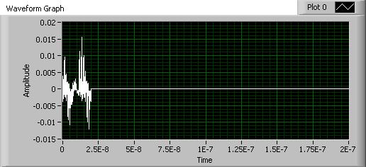

According to one of your previous posts, you should be seeing something like this on the graph. If that's not what you see I the scope, I can't help you because I don't have the scope or anything else. If you are seeing something on the scope but nothing on the graph, then are you sure that the scope is actually returning data? If you want more data from the scope, then you need to specify more than the 500 points you currently ae requesting. Change the stop number or change the set start stop to False. The help for this VI explains all of this. Have you read it?
I don't think you understood at all my previous post and that shows you are missing some fundamental knowledge of LabVIEW. Because I or no one else can reproduce your test setup, you need to provide us with the actual data that the scope is returning if you want help in formatting it. I will repeat what I said earlier step by step. Right click on the waveform output of tktds8k Get Waveform_mod.vi and select Create>Indicator. Do the same thing on the X Increment output. Do the exact same thing on the X Offset indicator. Now, run the program. Assuming that you have actaully gotten data from the scope, go to the operate menu and select Make Current Values Default. Save the VI. This will make the new indicators have the data from the scope so that someone can actually look at the data you are getting without having the scope. You can then post this VI.

created 3 indicators for output of tktds8k Get Waveform_mod.vi
Set False for 'set start/stop' setting.
thanks for the help

Okay, so this is the data you are getting from the scope. It looks similar to the screen shot of the scope. What else is the problem?
