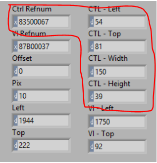

I am having a problem with occasionally outputting wrong values for a control.  I am programmatically moving the mouse cursor around the screen, between 4 controls.  The vast majority of the time it works fine.  Every now and then, the cursor jumps to the wrong part of the screen.  I tracked it down to the property node connected to the control refnum.  I connected indicators to the refnum going into the property node and the values coming out as seen in the block diagram:
This sub-vi is called for each cursor move.  The normal outputs for one of the controls are shown here:
However, sometimes the wrong width is output:
Sometimes the wrong top position (this is the top position of the previously selected control:
Sometimes the wrong height:
It happens for different controls, and many times it outputs the same wrong values - e.g. the wrong width of 1944 came out several times while gathering this data.

The sim code seems to do what you describe so I'm not sure where the wrong values are coming from.   You circled the width in the second image and said that 1944 is the wrong value but that is the same value that is shown in the first image in the Left indicator.  I'm not seeing where those values would get mixed up.

You are correct about the 1944, I hadn't noticed that...  However, that's not the point.  The Left indicator is the output of a calculation, while Width is the output of the property node.  The property node shouldn't output anything different than the value of that property - certainly not what was output by the Left indicator.

Some more info:  I duplicated the control property node and indicators:  Obviously, reading the same control refnum twice should give the same results, right??
Reading the same control refernce twice sometimes gives different results:
In this case, the first time it read it, it was correct, but the second time is incorrect.  (The incorrect value, 36, is the correct value from the previous read of the previous control refnum.)  Sometimes the first read is correct, sometimes the second.
