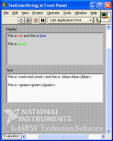

I always get a little peeved when formatting text.  What I have done for other attributes but have now adapted for color is to use tags <color>text</color> and borrow a little from the Bold Particular String.vi in vi.lib.  This is done pretty quickly so it may not handle all use cases (don't nest, check spelling).  If you want to change tags and/or add colors change the default value of the cluster array in Color String.vi.
Hope this helps.  You use one string (you don't have to display it) to keep the raw data and just display it using these VIs.
