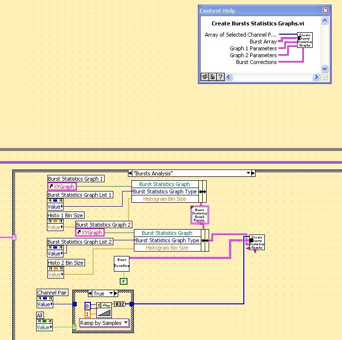

potential bug report (LV 2011): new input/output not updated in help window
I take that back. I have even beaten my previous record: 2 inputs missing! Smiley Happy
And yes, that's a LV 2 global...
Note added: If this can help, when I started moving the terminals on the diagram (I just added the controls which were missing on the connector pane above), the icon recovered the correct number of connections.

@ Jeff Bohrer: Wow, I discovered that indeed this is not just a Help window display problem but that the connector panes of the VI copies dropped on other VIs diagrams are not updated either.
Here is the VI with its connections incorrectly reported by the help window:
To clarify: I want "Graph 1 Parameters" to be the second input, "Graph 2 Parameters" the third and "Burst Array" the last. So I swapped inputs and if I select them on the front panel, they are highlighted at the desired location on the connector pane. The help window does not reflect this change, but I am getting used to that.
And here is the calling VI with the original connections still appearing OK, even though I swapped the inputs (as mentioned before):
To clarify: The highlighted second connector should be "Graph 1 Parameters", but it still is "Burst Array"... which it should not. The diagram should be either broken or the wires should have been rerouted to their new inputs connectors!!!
In other words, the "Swapping" has not been reflected in the calling diagram!
That is not a annoying feature. I think that qualifies for SERIOUS BUG...
Note added: Workaround >> drop the VI again on the calling VI. It will now have the correct connectors. I did not try the universal "Ctrl-R" trick of Ravens Fan...
