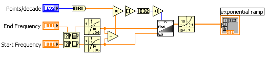

You could do something similar to the attached VI (LabVIEW 7.0).
