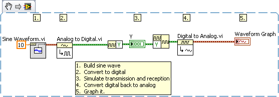

As homer simpsons would have said D'oh!. This is a Labview forum. So posting Basic code is not the correct thing to do LOL. Then I asked you to post code I meant Labview code. So I could get an idea of how much you understand, and whay you do not not understand. I have made some code to simulate your setup. You should be able to solve your problem now.

thank you for your reply
but it seem that you dont got me i asked about connecting labview with serial port to read and write and plot the  signal that i input it after digitizing and i said also that i did ADC AS HARDWARE NOT SOFTWARE if it wasnot hardware  what is the use
