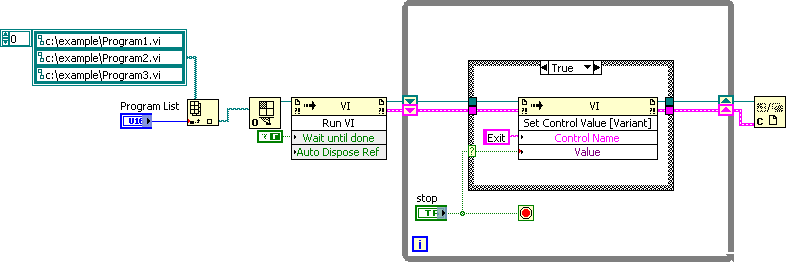

You can use VI Server to run a VI. The attached picture is a simple example. There are numerous properties and methods available in LabVIEW. The shipping examples show some of the others and there have been a lot posted to this forum as well.
Message Edited by Dennis Knutson on 09-28-2006 09:14 AM

@ Dennis:
Do I have to use 60 loops if I want to start 60 different programs? Or is there another possiblity?
Thanks for your great help.
Yves
Message 7 of 17
(4,259 Views)
You can have the choice if you modify a bit Dennis' example.
For instance you can put in a list (or ring or dropdown or enum) the names of the progam you launched and when you want to stop one of then, you first select it in the list and then click a button "stop this VI", you then get the appropriate reference to stop the VI.
Is my explication is not clear enough or do you need an example VI ?
