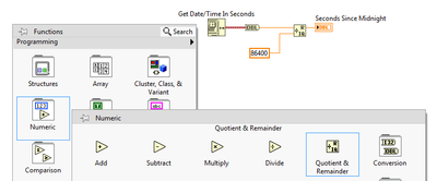

number of seconds since midnight
Time Stamp.  Front Panel under numeric control
Quotient Remainder.  Block diagram under numeric
To DBL.  Block Diagram under numeric >> conversion

@psuedonym wrote:
Sorry.
I mean the solution by crossrulz.
I am not understanding how that solution works because it looks like I have to manually enter today's midnight.
His solution works by dividing the current time (Time is stored internally as number of seconds elapsed since the Epoch) by the number of seconds in one day.
The remainder is the number of seconds elapsed since midnight of the current day.
That is as I said BRILLIANT!

@psuedonym wrote:
Don't I need to input the current midnight using this method?
Unless I am not understanding this.
No, you do not need to compute the number of seconds as midnight.  What my code does is divide the number of seconds since the epoch (Midnight on January 1, 1904, UTC) by the number of seconds in a day.  So the Quotient will be the number of days since 1904.  The remainder will be the seconds since today started (UTC time).
I just used a Timestamp Control (in the Numeric palette) as an input to prove the algorithm.  You can use the Get Date/Time In Seconds to use the current time.  Attached is a more complete VI that I would use if I was doing it for myself.  I saved it in LabVIEW 8.0.

FYI: Use the function instead of a Control.
The Remainder/Quotiant is found in the Numeric menu.

I love crossrulz's solution, but have to adjust for current timezone.  Or just do this.
