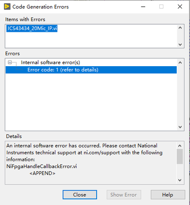

Hello everyone! I'm currently working on a microphone signal processing project where I can read time-domain data from 16 microphones. I then transfer the data via FIFO to another timed loop for FFT operations. However, I'm encountering the following error code when I try to compile and run the program, and I can't figure out why. Could anyone help me understand the reason for this? I'd really appreciate it!
Details:
An internal software error has occurred. Please contact National Instruments technical support at ni.com/support with the following information:
NiFpgaHandleCallbackError.vi
<APPEND>
<b>Complete call chain:</b>
niFpgaNodeInformation.lvclass:Get Array Term Size.vi
niFpgaFFTEmitDFIR.vi:2350002
niFpgaFFTEmitDFIR.vi.ProxyCaller

Hey Bob Schor,
Thanks a lot for the ideas! I checked lpfy's post and realized we're doing FFT in totally different environments - he's probably using real-time (RT) setup while I'm working with FPGA. The processing logic might be different between these two (just guessing), but I'll keep digging into it.
Thanks again!
