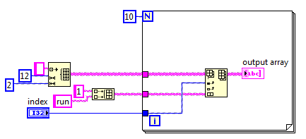

HI, i have a question about moving data in a 2D array by row i have not been able to do it so if anyone has an answer please let me know
a picture of what im doing is attached like i said
i want to move the "1 and run" by row not by column, if i change the index to row it will work but the issue is that the "run" stays under the "1" and i dont want that, if i change the index to column labview puts the data just like the picture attached but when i changed the index labview moves the data by column when want it by row

Hi, I think changing your code like this will give you the  behaviour that you are looking for.
That being said, your original code is a bit confusing. Why do you have a for loop? If you remove the for loop the code will do exactly the same thing.
This description is way too complicated and I cannot really tell what you want or don't want. Why don't you attach a picture showing us exactly the result you expect?
I any case, you seem to have a pre-formed empty array, so "insert into array" is probably the wrong tool, because it grows the array with each insert operation. Most likely, you want "replace array subset", replacing empty elements with new elements, keeping the array at a constant size.
Here are a couple of code fragments that might give you some ideas. Most likely you need to make changes to get the desired result (which I cannot guess from your description!) 😉

jeff, thanks bro, this is what i need
Don't forget to remove the FOR loop. I just pumps hot air. 😄
