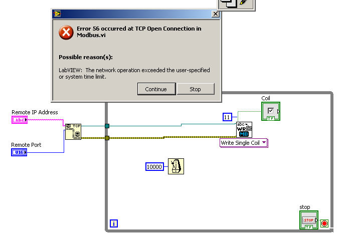

download modbus library for NI, setup modbus TCP communication with PLC slaver in labview 2012,
but when i run the VI, error 56 happens.Help~Smiley Sad
从NI网站下载的免费Modbus库,在Labview2012建立modbus TCP和PLC slaver通讯
如下图,运行时就出现Error 56,求助

1)enable highlight execution and determine where the error is occuring, its likely occuring in the initialization node because of a setting that might not be right.
2)Check your settings, typically port 502 is used
3)Check your IP settings
4) there is a new modbus library from NI that might offer you better results, and seems to be easier to employ.
Here is the link for the new library.
https://decibel.ni.com/content/docs/DOC-30140
You will need VI Package Manager installed first to install this add on, if you choose to use the new library.
