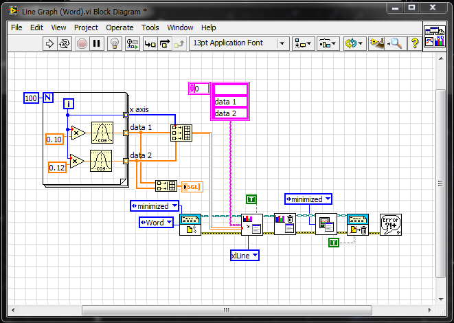

i am updating a word template and inserting graphs using word update graph.
Spoiler
I update 6 graphs then end with word quit graph.   My question is i do not want to see all the open micrisoft graph raw data opening up on my screen.   I get overlapping 6 microsoft graph windows with the raw data until the VI finally closes, then they all close.
Spoiler
is there a way to do this without having them open up on the screen while updating?
Spoiler
Jim

labview report generation.  word update graph.  I do not want to see it on the screen while it updates.

Thanks, i just added a close graph after each update graph instead of once at the end.
thanks for the help.
