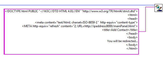

OK, finally, got it done by using Write Response.vi
don't know why redirect vi does not work.

Now I understand what you are trying to do and what is happening. Since you are submitting the form using POST, the redirect to the remote front panel is also going to be a POST, which is not supported (giving you a 405). The default for the redirect VI is to use a 307 redirect, which will redirect as a POST.
Instead, try changing the response code input terminal to 303 (or 302 if you need HTTP 1.0).
303 redirect

Pspangler,
you are right. I just tried.  It did work.
