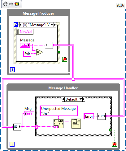

OK, I see the problem -- you are designing a Producer/Consumer system, but instead of having a single Consumer that decides "What did I get, and how do I consume it", you have multiple Consumers who squabble over the crumbs.
Here is a Very Simple Consumer/Producer of "Messages", where the "Message" is just a String ("Command").  Note that there is also something called a Queued Message Handler, where the Message is a Cluster having the "Command" part and a "Data" part -- I've coined (for myself, feel free to "borrow" the term "Channel Message Handler" where Channels replace Queues.
One trick with Channels is that they appear to "break" the "Input on Left, Output on Right, Parallel Loops arranged vertically (suggesting "simultaneity")" Rule, but you'll see how I deal with this.  I'm attaching this as a LabVIEW 2016 Snippet and VI so you'll be able to use it with 2017, but those (like myself) who use LabVIEW 2016 can also "play".
The Message Producer is a simple Event Structure that every time a Message is entered, it is put on a Messenger Channel.  If the Message happens to be "Exit", it exits the loop (and the Message Handler Loop, below it.
The Message Handler gets the Message through an S-shaped Channel that goes down, turns left, goes to the beginning of the Message Handler Loop, and goes in to a Channel Reader.  The Message is displayed and then acted upon using a Case Structure, one Case per Legal Message.  Any "unexpected" Messages (I used "Hello") go to the Default Case that warns of the Unexpected Message, and then generates its own Message, namely "Error".  Since this is a Messenger Channel, I take it out the right side, up, and join it to the Channel coming from the Event Structure, thus allowing the Message Handler to send Messages to itself.  It's not shown here, but what the Error Case does is simply use the Value Signaling Property of Message to send an Exit Message, stopping the Event Loop, and in the Message Handler, the Exit Case also stops the Message Handler.  Finally, there is a Valid Message ("Valid") that is the remaining Case for the Message Handler -- it does nothing, in fact, but if you run the routine and type "Valid", you'll see "Valid" appear in the Msg Indicator.
This is an exceedingly simple demo (believe me, I have more complicated CMH routines), but I hope is illustrates the idea(s) of Messenger Channels.  I use them a lot (more than any other Channel Wire so far).
