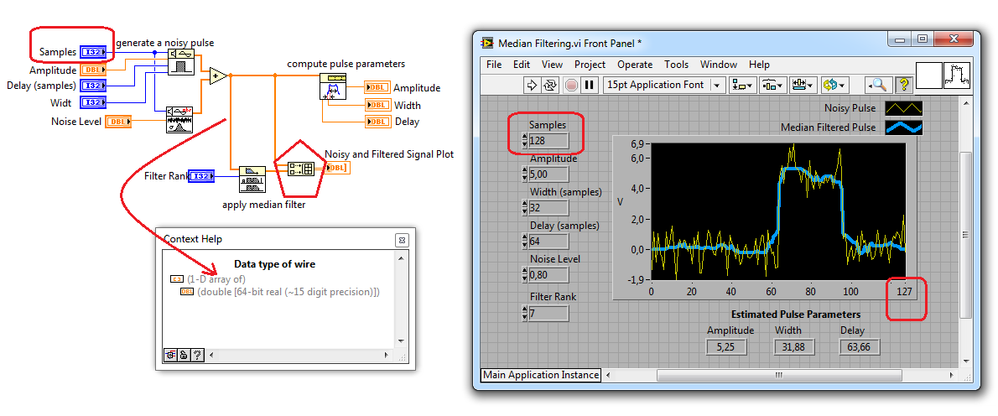

I think the problem is the input of the function. You are basically wiring an array with just one element. From the picture you posted y cannot see that you are adding the new values to any shift register or something like this.
I think you should be using the point by point median filter instead.

Thank you for your help, it ran about the same as the median filter I had before. However now I can change the rank and it will run (with the median filter it would not change when I changed the rank). I applied a digital indicator to the Filtered X from the filter and it read out a constant 0.00000 with 5 points of precision, while the actual current read out the usual noise fluctuating between -1 and 3. So I know that if it was working the average would atleast have decimal averages, not 0.0000 right?
I know I must be missing something simple.

Let me explain you a little better my point of view. I consider that the issue could be caused because you are not (the median filter function is not) analyzing the enough amount of samples. In the picture you will noticed that there is surrounded with a red circle all the evidence that could tell you the amount of points that are being analyzed at the same time. Now, I think you will be able to solve your issue by simply ensuring that you are passing more samples than the Left Rank.
Take a look to the example VI attached.
