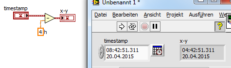

Hi rctrigger,
wow, a lot of code for a simple add/subtract operation:
You haven't understand that "use a DBL float with unit enabled" thing before?
I want my final output to be in military (24-hour) time
Then you need to use a proper display format or format string. All the formatting options are explained in the help!

Yes, well time calculations are an area where units work really well. For example, you can easily expand on Gerd's example to add any sort of arbitrary time offset:
Mike...
