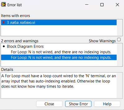

Obviously, the A and B indicators need to be 2D arrays. Are they? (what does it tell you if you hover over the broken wire?)
You also did not wire the lower loop correctly. In your case, LabVIEW cannot tell the number of iterations. Do you know why?

yes,A and arrays must be 2d,but minimum elements 1d.Can you fix it?

Right-click they array indicator...add dimension. (or just grab the index and resize down for two indices.)

What i Should do?

@zhako wrote:
What i Should do?
Compare with my picture!
(At this point in the learning curve you should not try to be smarter than me and leave out stuff that you think is not needed)

@zhako wrote:
What i Should do?
Read the error Details, it tells you exactly what to do.
