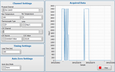

I have connected a thermocouple K-type to pin 55,56 on a NI USB-6353 board.
I have then tested with both MAX and LabVIEW: Thermocouple -SW-Timed Input.VI if the setup works.
The temperature input is what to be expected, except in both test set up, it display a temperature of 3400* Celsius often. This temperature is shown more if i physically touch the leading part of the thermocouple.
I have tried with different thermocouples, but have the same errors.
What could course the spike in temperature reading?

jolyky,
Signals like that typically indicate an intermittent break in the TC circuit - such as a loose connection.
-Dave
(183 Views)
Double check the terminal connections and the wiring.
Try replacing the wires and ensure they are properly attached to the terminals.
(171 Views)
Could be electrical noise, is the T/C mounted to something or in free air? If connected then provide details.
-AK2DM
