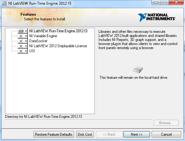

A second workaround was to install the RTE without selecting anything else in the installation window (see image below). I am interested to hear if this fixes the long boot times for those of you who can recreate this.
