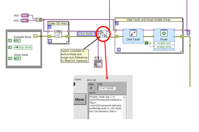

error number is -2147138395
I’m seeing error -2147138395. The online master state shows Operational, but the Interactive Test Panel (Browser) also reports -70229.
Has anyone run into this combination of errors? How can I resolve it?
(573 Views)
To resolve error -2147138396 , please add the Set Scan Engine Mode VI to your project and set the mode to Active
You can find it here: https://www.ni.com/docs/en-US/bundle/labview-api-ref/page/vi-lib/niscanengine/scanengine/set-scan-e…
Let me know if the issue persists.
