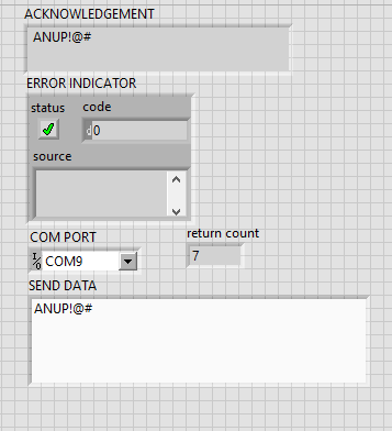

the error im facing is that
1. it reads the data but it still shows timeout exired.
2. timeout expired error and not reading the data.
3. A framing error ocurred during transfer
4. A overrunn error ocurred during trnasfer. A character was not read from hardware before the next character arrived.
help?
Message 15 of 21
(1,298 Views)
I guess you don't send/use termination character correctly.
Qestit Systems
Certified-LabVIEW-Developer
Message 16 of 21
(1,291 Views)
Hi Anup,
is this still the same communication line as in all the questions before?
@AnupSW13 wrote:
help?
  • You didn't cleanup your block diagram so use AutoCleanup!
  • You forgot to implement complete error handling.
  • You seem to forget about appending LF or CR chars with the command message.
  • You don't need to call VISAOpen and ConfigureSerialPort both. Use only ConfigureSerialPort before the VISAClear function!
  • Hide the labels of the functions, we usually know them or use the context help window to read their names. (It just clutters the block diagram.)
Message 17 of 21
is it correct now?
Message 18 of 21
(1,269 Views)
@AnupSW13 wrote:
is it correct now?
How can we know from a picture?
Read this answer and then come back again:
https://forums.ni.com/t5/LabVIEW/Delta-elektronika-VISA-read-in-error/m-p/4409726#M1299458
Rolf Kalbermatter  My Blog
Message 19 of 21
(1,265 Views)
Hi Anup,
@AnupSW13 wrote:
is it correct now?
You still forgot to use AutoCleanup…
Message 20 of 21
(1,256 Views)
