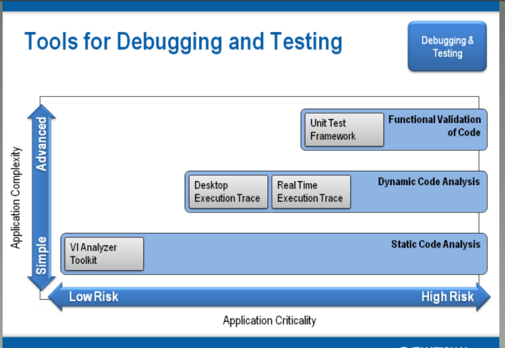

So far I know I can use DSM to check CPU load  and memory usage. Beside from that If I use below screen shot toolkits ,those will give me more on code level and  all are each individual VI trace time.

Stress testing is inherently application dependent. Basically it consists of looking at what your application can do and doing a lot of it.
Say for example, your application lets multiple remote users establish a connection and log some data. An example of a stress test would be to see how many simultaneous connections it can handle without failing or degrading it performance to an unacceptable degree.
What is your realtime application doing?

  Thank you mike..We are using for robot control...
