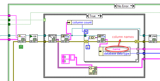

I am using labview to read and write data with Mysql, i created some columns in Mysql table then i made the code in labview to query the table,problem is why i can not have the column at the front panel? Is the column should manualy type in at the front panel?

Any database will only return the data except if you explicitly request it. So I suggest you to use build array in the Array tool-set and add the title that you already have in a 1D array as a constant.
Benoit
This won't always be possible especially if you are calling stored procedures or you are executing queries like "SELECT * FROM table".  This is where the recordset is useful.  In this snippet, I am executing a stored procedure, fetching the recordset data and grabbing the column names and datatype from the recordset.  Fetching the datatype will help with formatting the data later.

Hi
Could you please send me this VI,then i can study
Message 4 of 8
(5,017 Views)
I won’t be able to post anything until Monday. But all of the VI shown are in the database toolkit. The first one is Create Parameterized Query.  This one is a bit complicated but can be removed if you are executing a simple select statement.  Just duplicate the code shown and wire up an SQL statement to the Execute Query VI. The other VI is Get Recordset Properties.

See attached.
