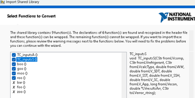

unfortunately I have to pass some text in (strings, chars, whatever).
String length is oversized, keep it at 128. Hard to use that with 10 characters only and not worried about memory etc.
Ok I try with character pointers, still got 4 days until I leave this place.
changing the output from array to string did not help. That only leaves strings. One should hope doubles and ints get through ok. Even have the bool changed to an int,
this is what the wissard says
extern "C" DllExport string TC_inputs(string fromLVcomp, string fromLVrefrigerant, string fromLVcalcType, double fromLVkW, double fromLV_SDT, double fromLV_SST, double fromLV_SSH, double fromLV_SC, double fromLV_App, int fromLVecon, string* LVresults);
this is in the header
its in the dll as well (dll export viewer)
funny enough, sometimes its in the dll export viewer but not in Dependencies, but here it is
maybe needs to be a string pointer for inputs, I shall try

this is in Labview
void TC_inputsS(CStr fromLVcomp, CStr fromLVrefrigerant, CStr fromLVcalcType, double fromLVkW, double fromLV_SDT, double fromLV_SST, double fromLV_SSH, double fromLV_SC, double fromLV_App, int32_t fromLVecon, double *LVresultsArr, CStr toLVerror_string);
this is the header
void TC_inputsS(char* fromLVcomp, char* fromLVrefrigerant, char* fromLVcalcType, double fromLVkW, double fromLV_SDT, double fromLV_SST, double fromLV_SSH, double fromLV_SC, double fromLV_App, int fromLVecon, double* LVresultsArr[5], char* toLVerror_string);
I am not sure why function foo was not recognised but function boo was, its the exact same thing. But at least I know that output array plus error string (2 function outputs) could be working as well instead of cramming everything into one string.
void foo(char* fpar1, double fpar2, double* farr3[5])
double arr3[5] = { 1.1,2.2,3.3,4.4,5.5 };
void boo(char* bopar1, double bopar2, double* boarr3[5])
double arr3[5] = { 1.1,2.2,3.3,4.4,5.5 }; //works
Message 56 of 73
(648 Views)
Not sure what you mean with it works. It definitely will not return anything to LabVIEW. The parameter name is called boarr3, the variable you do the initialization for is called arr3. Not the same thing.
And you can't return data to LabVIEW like this. Well you can but only as a pointer sized variable. Then you can play C compiler on the diagram by copying the data from that pointer into a LabVIEW array. Or you could do it on the C side instead:
void boo(char* bopar1, double bopar2, double boarr3[5])
    memcpy(boarr3, arr3, 5 * sizeof(double));
And of course make sure to configure that parameter in the LabVIEW Call Library Node to contain at least 5 array elements.
As to why boo works and foo doesn't for you: My guess, you still used an old header with a definition that LabVIEW does not like. The DLL only contains function names, nothing else. The LabVIEW Import Library Wizard can't determine anything about the parameters and their types from the DLL. It uses the header you specify and matches the function names in there with function names it finds in the DLL. And yes even a header file is not really enough to allow the wizard to create really correct VIs. It has to guess in several aspects how the C syntax is meant to be applied and those guesses are only really right if the DLL interface is pretty trivial. As soon as arrays and strings are concerned, things go haywire very fast.
Rolf Kalbermatter  My Blog
Message 57 of 73
(642 Views)
foo and boo have the same header, so no idea why the wizzard only recognized boo
extern "C" string1_API void foo(char* fpar1, double fpar2, double* farr3[5]);
extern "C" string1_API void boo(char* bopar1, double bopar2, double* boarr3[5]); //works
memcopy worked, before the array returned only the address in cell 1
also needed to do memcopy for the string, otherwise it was just the 1st letter
int stringlength = 128;
string errorMSG = "no error, nice.";
memcpy(rpar3, errorMSG.c_str(), stringlength);
rpar3[stringlength - 1] = '\0';
now its a happy roo. Beeing in 'straja and all that.
wow, it hooked up, showed this (because no inputs yet). But connected to dll, got error from there. Relief
