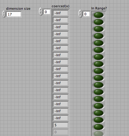

Stumbled on som weird behaviour of the In Range and Coerse primitive. If I run the the attached code (LV2010, no patch) on Linux Ubuntu, the behaviour changes when the array size gets bigger than 15. Below 15, output is array of NaN, above 15, output is array of -inf.
Can you reproduce this on your platforms (as mine is not supported)? Has this changed with a patch?

Confirmed on Mac OS X 10.5.8, LV 2010 10.f2
Lynn
Message 2 of 9
(4,272 Views)
Confirmed on Win XP, LV 2010f2
Actually, what I see is 15 elements and below, all elements remain NaN.  For 16 and above, the zeroth element is coerced to 5, the remaining elements are coerced to -Inf.
Message 3 of 9
(4,261 Views)
I see something similar. For odd values of dimension size >15 the last element is 5 but the Coerced? output is still false.

When I first ran the VI, I swear the 5 was in the top position.  I've since opened the VI again (I closed the VI after I finished replying earlier) so I could see about the odd vs. even # of elements, and I'm now seeing what you are seeing Lynn.  So far I haven't been able to replicate what I saw earlier with the 5 in the first position.
UPDATE:  LV 2009SP1 (also on WinXP) does not show this behavior.

Anything dealing with arrays of size 16 or greater is almost certainly related to the SSE implementation introduced in 2010. I've filed CAR 277565 on this.
