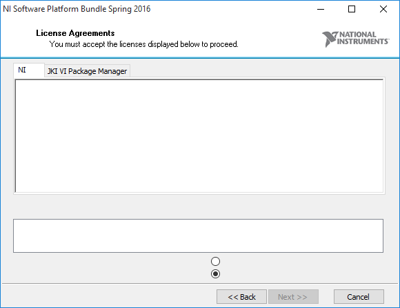

I have just encountered exactly the same issue, but may have a bit more information to add.
Work PC -- Windows 7 (x64) with LabVIEW 2015 (32-bit) installed from Academic Fall 2015 DVD-on-USB.  Worked fine.  Tried to install LabVIEW 2015 SP1 from Academic Spring 2016 DVD-on-USB -- also worked fine.  No problems (and none expected).
Home PC -- Windows 10 (x64, Enterprise) with LabVIEW 2015 (32-bit) installed from (same) Academic Fall 2015 DVD-on-USB.  Worked Fine.  Tried to install LabVIEW 2015 SP1 from Academic Spring 2016 DVD-on-USB -- get errors (even when doing a minimal Install of just LabVIEW, no Toolkits, Modules, or Drivers).  Second Error Message appears when I click "OK" on the first one.
When I first saw this, I restarted my system and tried again -- the above screen shots were captured at that time.

I just spoke to an Applications Engineer at NI who is following up this Support Request.  We've reviewed what I've done, I've run a test or two he suggested (and still get the same failure), so he's now trying to construct a Windows 10 VM so he can try himself with the Software Platform Bundle Spring 2016.  Should know more tomorrow.

There is a possibility that I may have been using a mal-formed .ISO file created from the USB Flash Drive containing the Spring 2016 Distribution.  I have a second copy of the Key on a Share at work, and have found that I do not get the immediate Failure at the time of entering the "Do you accept the License Agreement?" screens on either Windows 7 or Windows 10, either running as the "native OS" or as a VM, but do seem to get this if attempting to mount the ISO and install from there.  [Note that I've had no problems installing from ISOs created from installation kits in the past, including LabVIEW 2015 Fall Distribution].
I'm currently building another ISO, and will test it to see (a) if it differs from the earlier one, and (b) if it suffers the same problem.  I have also touched base with NI Support on this issue.

I suspect that the ISO that I was using to install onto my Windows 10 machine (home) may have been faulty.  I have just created a second ISO from the Spring 2016 Distribution and verified that on my Windows 7 machine (work) I do not get this error.  I will try this new ISO on my home Windows 10 machine this evening and will post the results here.  I have informed NI that this may have been a "faulty medium" issue, and they are tentatively marking this as "Resolved".

SUCCESS!!  After recreating an ISO image from the Spring 2016 Distribution, I have successfully installed it on my home Windows 10 system.  It's unclear to me how I managed to screw up the original ISO creation -- the file/folder pattern (what you see when you mount the ISO) was the same, running Setup seemed to work, giving the "expected" responses, right up to the point where the License Agreement popped up and was blank.
Sorry I don't have a solution for the Original Poster, other than to say be sure you have the original or a verified copy of the NI Distribution Kit -- the Spring 2016 Kit does, indeed, appear to install "as expected" on Windows 10.
