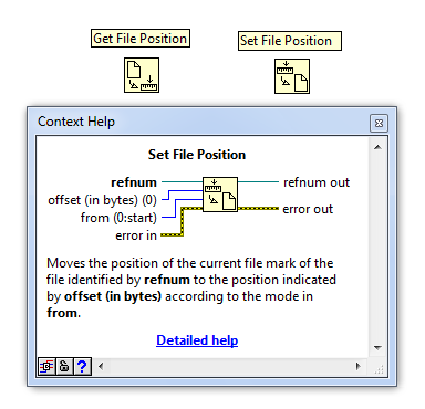

Perhaps its an issue with your file position?
