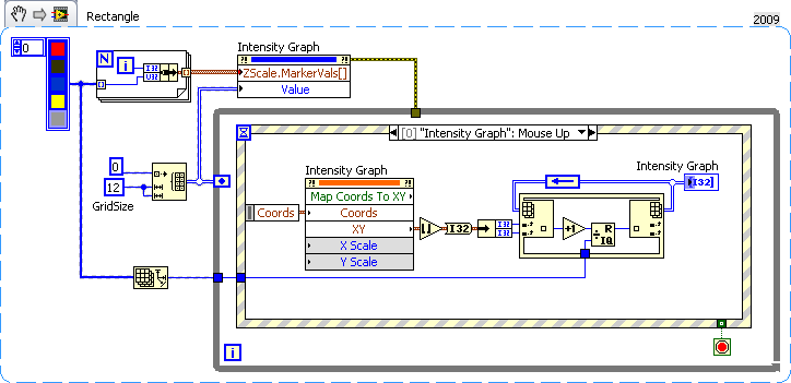

If it were me, I would get the color and numeric value in one place by using an intensity graph.
Easy to change the grid size, number of colors you want as well as the colors themselves.
