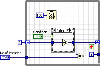

I want to control the iteration count of FOR loop, is it possible?
 I'm checking a condition in FOR loop and if I get FALSE then I want to repeat the same
i.e in this case iteration count (i) of FOR loop should not get incremented.
Here you needs to write a logic to generate your own (i) Value. In the for loop you cant programatically change the no of iteration after it gets into the loop. better go with the wile loop.
