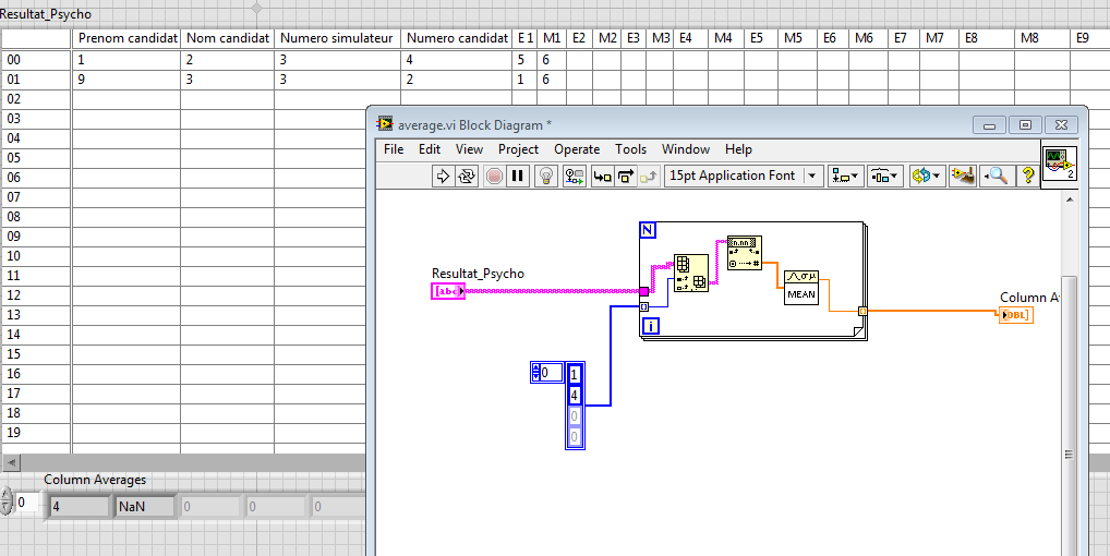

how to calculate the sum of the values of some columns of a table
Did you check the number of elements in the circled array?

Please go through some basic LabVIEW materials. You need some understanding on the basic programming and also the use of LabVIEW primitives.
Message 13 of 23
(1,488 Views)
It also helps things if you learn to keep your diagrams clean.  Avoid wire bends and keep things concise.

thanks for your help.
but i didn't get the average yet Smiley Very Happy
Message 15 of 23
(1,471 Views)
You are picking the rows. Change the Index wire to column inside the for loop.
Message 16 of 23
(1,467 Views)
i already did it but nothing,maybe the mean vi doesn' t caclulate the average value
Message 17 of 23
(1,461 Views)
This is what I get.
Message 18 of 23
(1,451 Views)
that' the result that i wanna get,what is the difference between my vi and yours.the mean vi i guess Smiley Frustrated
NB: i have labview 2012 i can't use your snippet
Post your latest VI.  There has to be something hidden that the picture is not showing.
