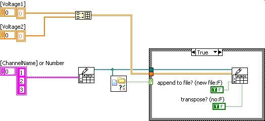

It's the same case as previous but make a double access to file in order to start with the channel name or number then write voltage with append option.
In this example, i write String as channel number but because the function is polymorphic, you could write a simple interger too.
The problem with this function 'Write To Spreadsheet File.vi' native to LabVIEW is that you can not manage error and if you have an error to the first call, you probably have the same to the second. So, insert a parade : a function to know if the file exists. it's a primary test to know if there is no problem with the first call.
But if you need to read it don't forget to ignore the first line as voltage data.

I hadn't the VI any more but I just do it again, see attached file.
So, if I understand, it's a problem of format => add %#.1f as format entry to have 1 or none digit of precision, %#.2f to have 2 or none, etc...
But when I see your attached image, you use another method (by Express) and you seem to be near the soluce, aren't you?
