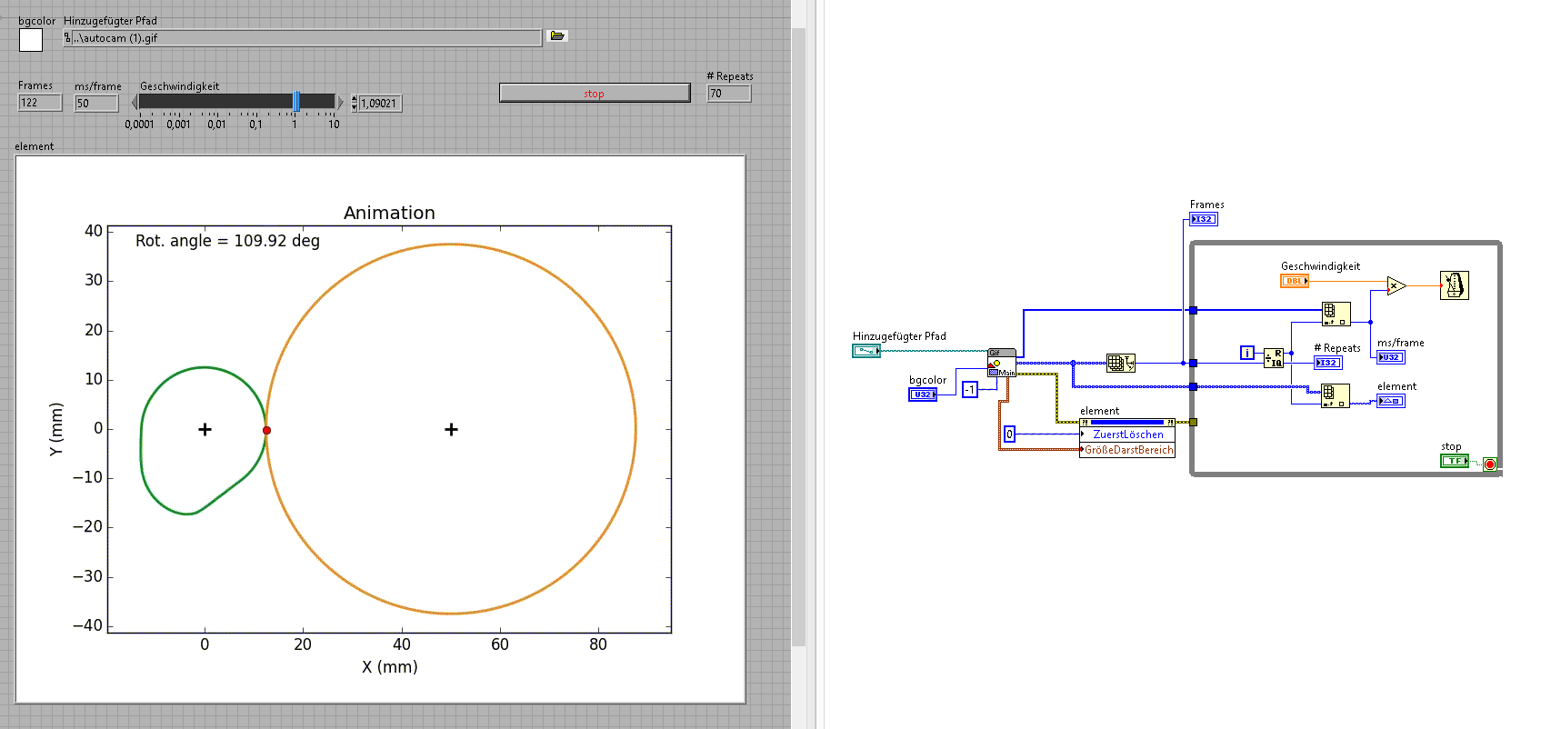

how about this well written library, which is completely written in G:
https://decibel.ni.com/content/docs/DOC-3293
