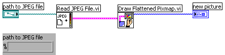

I assume you mean you have a picture of the map and want to put it into a picture control. Under the graphics formats palette, you can find VIs to read in an image file. You can then take this image data cluster and add it to a picture control as shown in the attachment.
