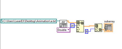

This is what I have done so far, but the subarray indicator would return me the value of row 9 in my text file. So can you please tell me what change do I need to make?

As for the how do I retrive a particular line from my text file question on the duplicate thread. How do you wire a "13" to the ReadLine function?
(3,200 Views)
Hi Fred,
I would wire a 13 to the count input:
How would you interpret the context help?
