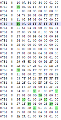

From your ISO CAN library, the mutiframe part seems to be not working at a specific part when writing blocks say for example
Expected:
TxID: 21 xx xx xx xx xx xx xx
TxID: 22 xx xx xx xx xx xx xx
TxID: 2A xx xx xx xx xx xx xx
RxID: 30 0A 05 xx xx xx xx xx
TxID: 2B xx xx xx xx xx xx xx
Actual:
RxID: 03 7F 36 24 xx xx xx xx
Not sure on what I'm missing out..?
This hasppens when I'm trying to flash an ECU at Transfer Data block...
