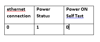

Sorry for the trouble. The expected output is each time I click on the GO button, the table needs to keep getting populated(in this case, the same status of the buttons).
When I run the vi for the first time and click on GO, this is the output I get on Word
As the vi keeps executing when I press the GO button the second time, I want the same data to be written below(as the status of the buttons remains unchanged) but this is the output which I get.
From the above picture, you can see the rows 2nd and 3rd are being populated but the values are not getting populated.
